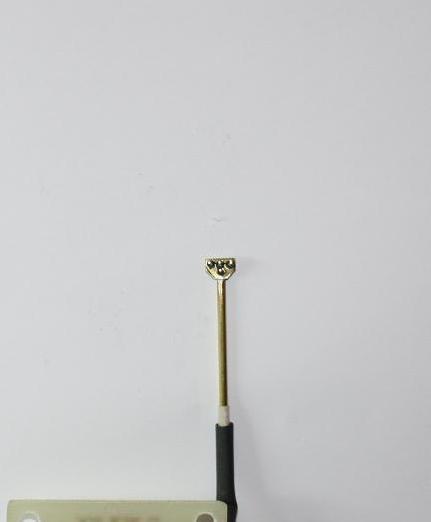

Handmuster:

Hallo Per,
kannst du bitte noch mal ein Bild reinstellen, wo das Signal näher zu erkennen ist...

Re: Dreipunktsignal
Beitrag von Per Lind »
Leider nicht. Diese sind nur eine Prototyp und bin nicht bei mir.
Eine Bessere Bild kommt später.
-Per

Bo Andersson
Re: Dreipunktsignal
Beitrag von Bo Andersson »
TRACK WAY SIGNAL
I can translate my Swedish through Google translate, so please excuse the interpretation becomes.
I am in the testing stage by making this light rail signal with the help and information by Per Lind.
There are two types of signals.
Some pictures on the CAD file.
[IMG] http://i32.tinypic.com/b9go7t.jpg [/ IMG]
The idea is that the fiber optics are used, and then connected to a control module, this is not clear yet.
In this way, the signal kept to a reasonable scale accuracy
Signal Tablet thickness will be 2mm and confining light optics so this is not visible.
The data are processed, and will walk away with much more to the etching
Sincerely Bo

Werner Jurkowski
Re: Dreipunktsignal
Beitrag von Werner Jurkowski »
Hej Bo,
When looking at your drawings I notice that you’ll have problems with bending the tiny parts.The bending edges require grooves, otherwise you get the edges too rounded and not in the correct positions.
Also I would keep the front as an individual part because the holes are too close to the bending edges. When bending you would distort the fronts.
For a better fit I would connect all side strips individually to the signal‘s back. At the edges which join after bending or where the front part will be soldered or glued to the pre-formed signal box, I would do the backs of the parts smaller.
Hälsningar från Berlin
Werner
Bo Andersson
Re: Dreipunktsignal
Hi Werner,
It is not clear that there will be vikkanter so that this screen can be folded in a simple manner.
Must go through some of etsaren and hooks so that the signals do not fall out of the etching.
idea is also to make these screens in 0.2mm nysilverplåt.
I have been using a higher magnification print and weight up to see if everything is correct.
Thanks for your feedback, is appreciated.
Best regards
Bo
